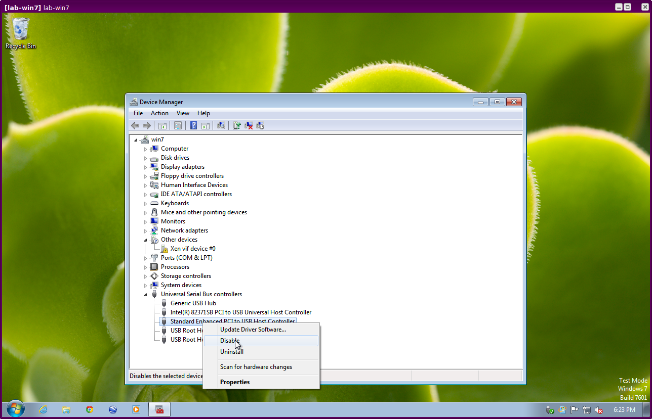

Attached devices in Windows HVM stop working on suspend/resume
After the whole system gets suspended into S3 sleep and subsequently resumed, some attached devices may stop working. To make the devices work, they should be restarted within the VM. This can be achieved under a Windows HVM by opening the Device Manager, selecting the actual device (such as a USB controller), ‘Disabling’ the device, and then ‘Enabling’ the device again. This is illustrated on the screenshot below:
