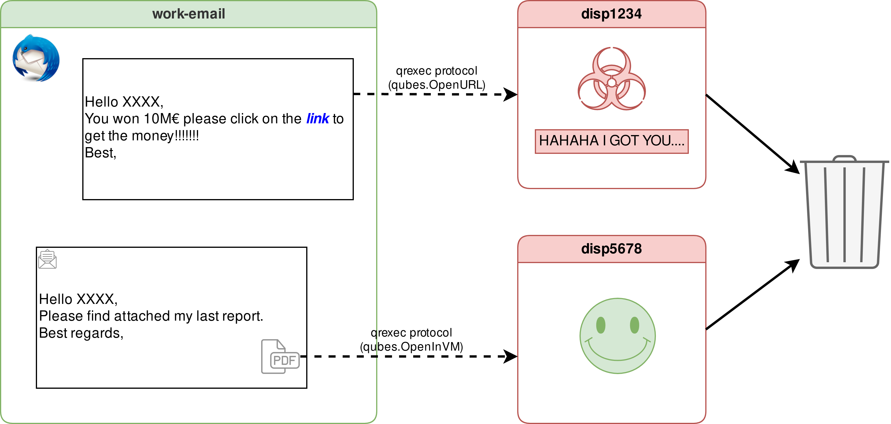

Example of how disposables can be used to safely open untrusted links and attachments in disposables
In the work-email qube, the user clicks on a link. This link is opened in a new disposable (through the qrexec protocol qubes.OpenURL). The link contains some kind of malware that infects the disposable qube, but it is harmless for the work-email qube, as the links was opened in a separate environment from the mail client, the mail box is safe. The disposable is later destroyed.
In that same work-email qube, the user now opens a PDF attachment. Using the qrexec protocol (qubes.OpenInVM), the PDF is opened as in a new disposable qube, this time, the file looks clean, but as we can never be sure, the user prefers to default to open files in disposables. The disposable is later destroyed.
This diagram provides a general example of how disposables can be used to safely open untrusted links and attachments in disposables. You may find more on why one would want to use a disposable on the first disposable qube article. Please note that the blog post is dated and some of the information it presents are not accurate anymore.

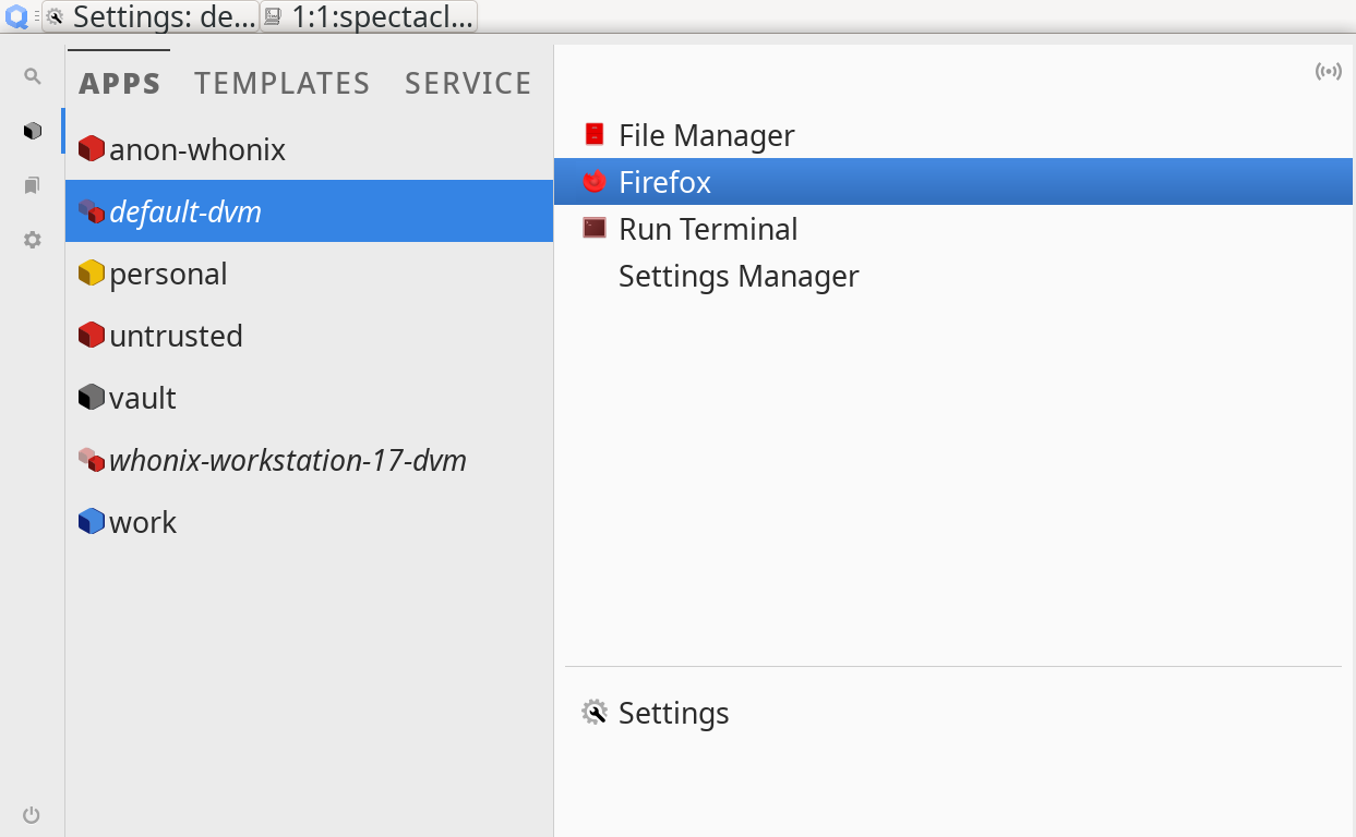

Disposables can be started with Qubes logo iconQubes App Menu (Q icon) ‣ APPS ‣ default-dvm. Select the application you wish to launch in a new disposable, and one will be created for you. Notice that the application was not opened in the disposable template default-dvm: instead, it opens in a disp1234 qube. This is because applications from a disposable template listed in the APPS tab will open in a new disposable.

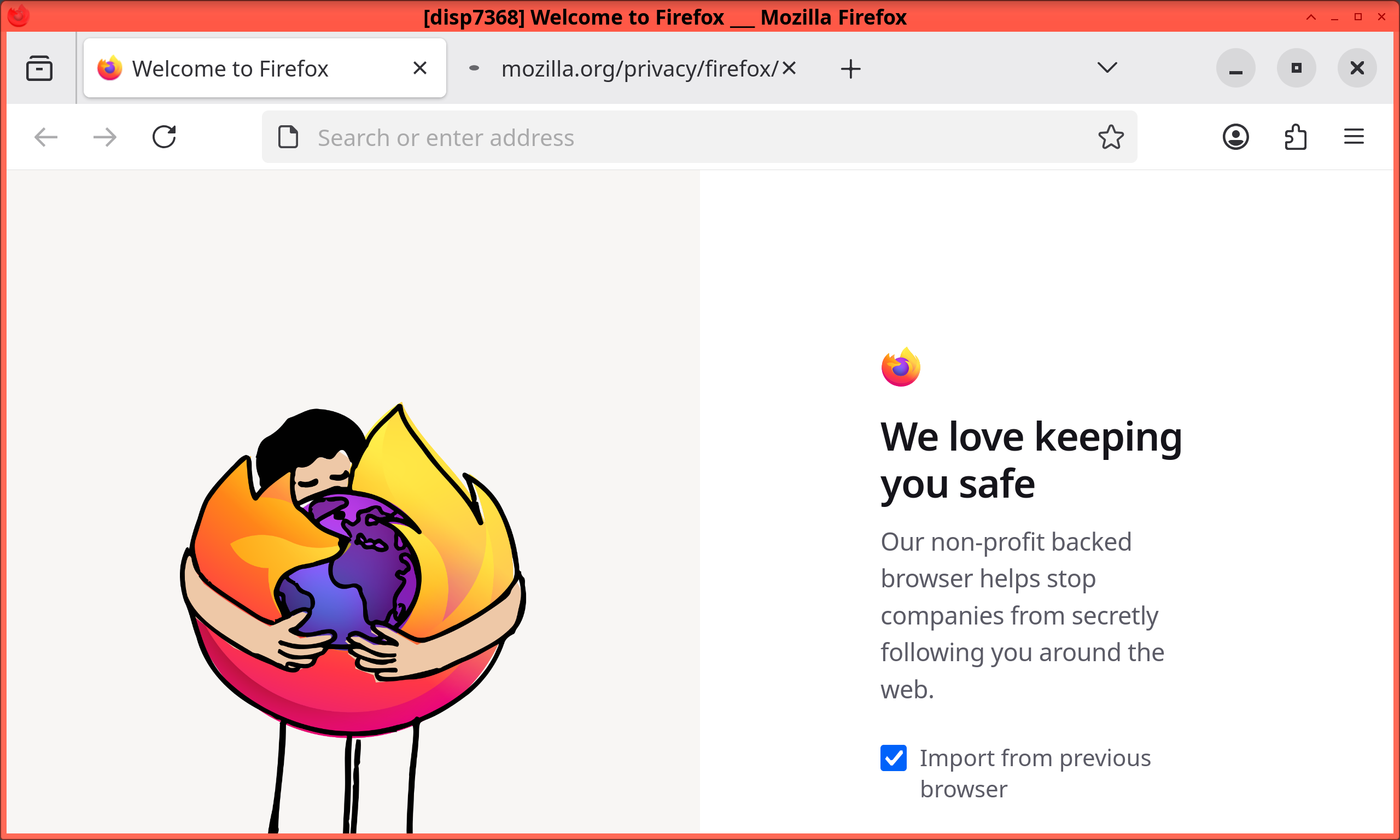

Sometimes it is desirable to open an instance of Firefox in a new fresh disposable. This can be done easily using the app menu: just go to Qubes logo iconQubes App Menu (Q icon) ‣ APPS ‣ default-dvm ‣ Firefox. Wait a few seconds until the web browser starts.
Application menu being used to open an Firefox from the ``default-dvm`` in a disposable qube. Firefox opened in a disposable qube in the default page.
It is possible to do the same as above using the command line:
user@dom0:~$ qvm-run --dispvm=default-dvm --service -- qubes.StartApp+firefox
The browser is opened from a disposable based on the default-dvm qube.

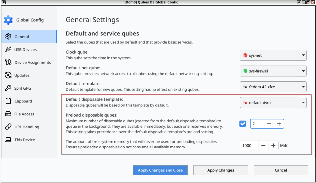

Preloading from the system’s default disposable is possible with the Qubes logo iconQubes App Menu (Q icon) ‣ Settings (icon) ‣ Qubes Tools ‣ Qubes Global Config ‣ General ‣ Preload disposable qubes. You can start with a small number of qubes to preload, for example 2, and use Apply Changes and Close to save the changes.
Global config window with preloaded disposables items emphasized and preload disposable setting configured to ``2``.
This can also be changed from the command line from the GUI domain, with qvm-features targeting dom0:
user@dom0:~$ qvm-features dom0 preload-dispvm-max 2

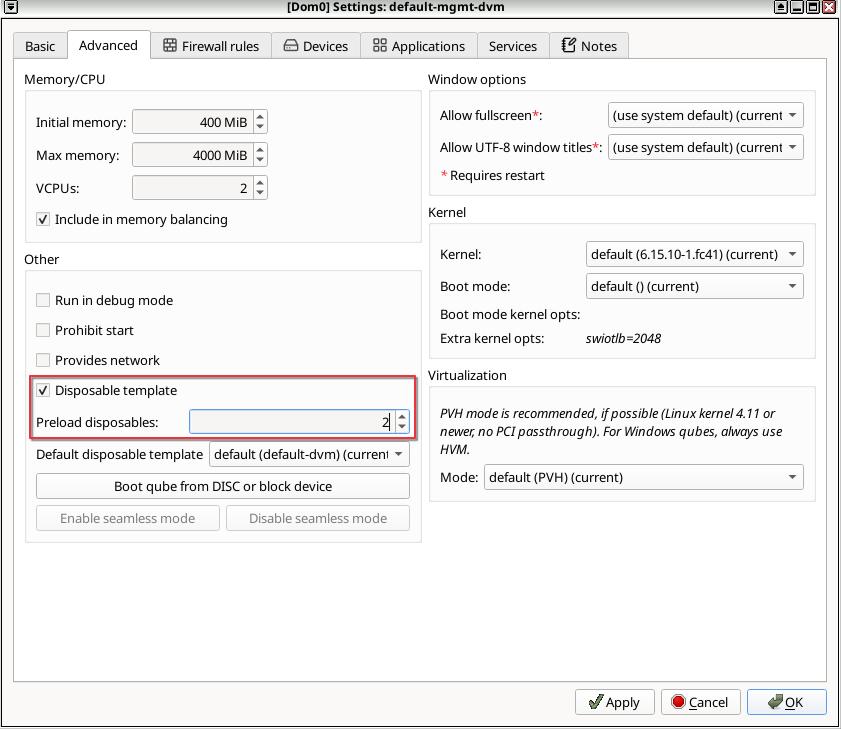

To configure, for example, the default-mgmt-dvm qube using the app menu and qube manager, as it is an internal qube, first we need to make it visible, in the Qubes logo iconQubes App Menu (Q icon) ‣ Settings (icon) ‣ Qubes Tools ‣ Qube Manager ‣ View ‣ Show internal qubes. After this step is completed, Qube Manager ‣ default-mgmt-dvm ‣ Settings (icon) ‣ Advanced ‣ Preload disposables, choose a number such as 2 and click OK to apply and save changes.
Note
You may deselect Show internal qubes to hide them again after making the changes.
Qube settings of ``default-mgmt-dvm`` with preloaded disposable setting configured to ``2``.
This can also be changed from the command line from the GUI domain, with qvm-features targeting default-mgmt-dvm:
[user@dom0 ~]$ qvm-features default-mgmt-dvm preload-dispvm-max 2
