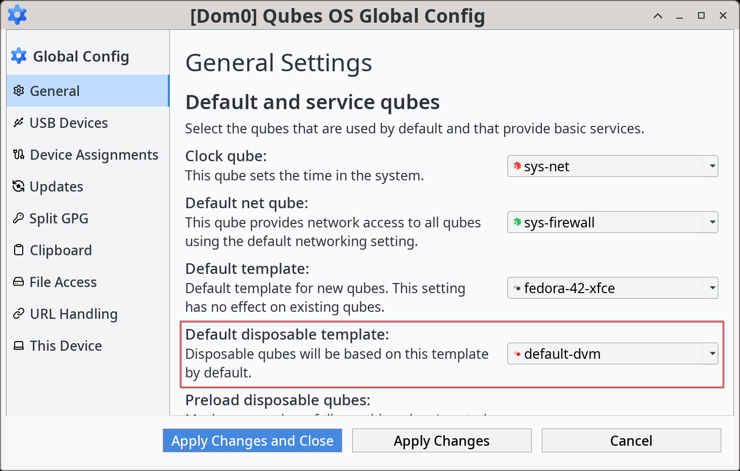

Set the default disposable template
Set the system’s default disposable template
The system’s default disposable template can be configured in Qubes logo iconQubes App Menu (Q icon) ‣ Settings (icon) ‣ Qubes Tools ‣ Qubes Global Config ‣ General ‣ Default disposable template, choose to your liking and click Apply Changes and Close.
Global config window with system's default disposable template item emphasized.
This can also be changed from the command line with with qubes-prefs:
user@dom0:~$ qubes-prefs default_dispvm <DISPOSABLE_TEMPLATE>
The above setting is used whenever a qube has the property default_dispvm set to default, request starting a new disposable and do not specify which one, for example, via file manager context menu Edit/View in disposable qube or qvm-open-in-dvm tool), also with Convert in disposable qube (qvm-convert-img, qvm-convert-pdf).

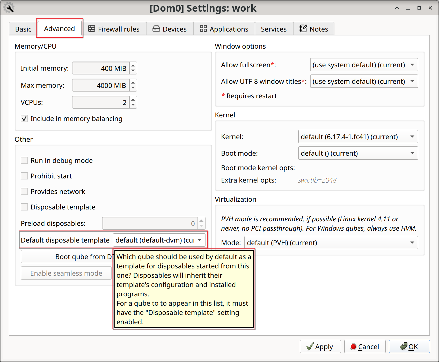

Set the qube’s default disposable template
The per qube default disposable template can be configured in the app menu, for example, to change the setting for the work qube, in Qubes logo iconQubes App Menu (Q icon) ‣ APPS ‣ work ‣ Settings ‣ Advanced ‣ Default disposable template, select your preference and click OK to apply the changes and close the window.
Qube settings of ``work`` with qube's default disposable template item emphasized.
This can also be changed from the command line with qvm-prefs:
user@dom0:~$ qvm-prefs work default_dispvm <DISPOSABLE_TEMPLATE>
A qube can be allowed to use multiple disposable templates if you choose so and have configured the policy to allow.
If the <DISPOSABLE_TEMPLATE> is referenced, set an alternative, and if no alternative is available, set it to an empty value.
Retire the qube from being a qube’s default disposable template
Now let’s check the per qube default_dispvm property for any qube, in this case, the work qube, in Qubes logo iconQubes App Menu (Q icon) ‣ APPS ‣ work ‣ Settings ‣ Advanced ‣ Default disposable template. Or use the command line equivalent:
user@dom0:~$ qvm-prefs <QUBE> | grep default_dispvm
default_dispvm        -  <DISPOSABLE_TEMPLATE>
This process must be repeated for every qube that references the <DISPOSABLE_TEMPLATE>.
