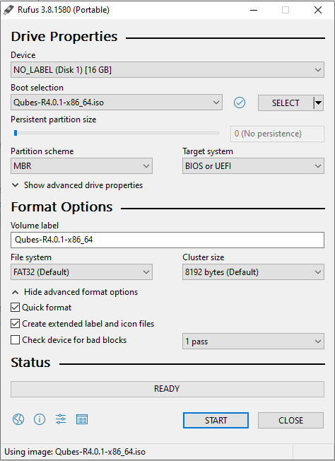

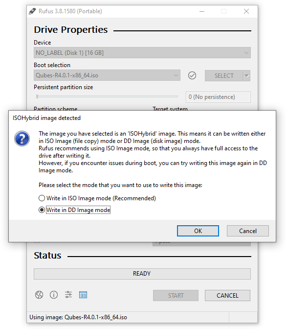

On Windows, you can use the Rufus tool to write the ISO to a USB key. Be sure to select “Write in DD Image mode” after selecting the Qubes ISO and pressing “START” on the Rufus main window.
Note
Using Rufus to create the installation medium means that you won’t be able to choose the “Test this media and install Qubes OS” option mentioned in the example below. Instead, choose the “Install Qubes OS” option.
Rufus menu

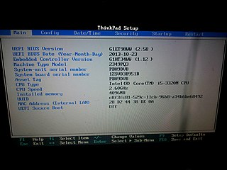

Here’s an example of what the BIOS menu looks like on a ThinkPad T430:
ThinkPad T430 BIOS menu

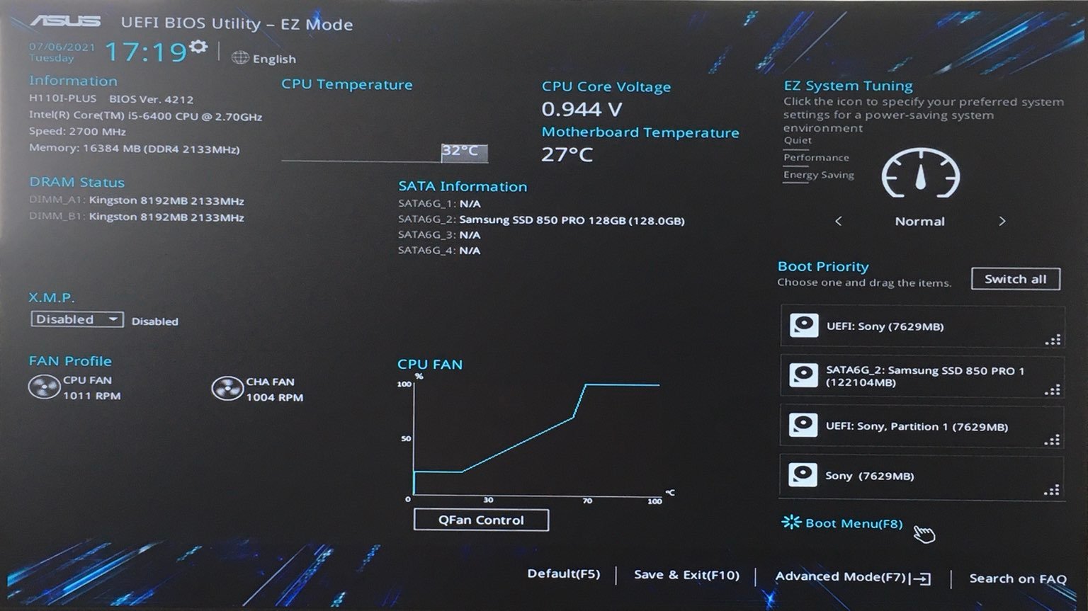

And here’s an example of what a modern UEFI menu looks like:
UEFI menu
Once you access your computer’s BIOS or UEFI menu, you’ll want to go to the “boot menu”, which is where you tell your computer which devices to boot from. The goal is to tell the computer to boot from your USB drive so that you can run the Qubes installer. If your boot menu lets you select which device to boot from first, simply select your USB drive. (If you have multiple entries that all look similar to your USB drive, and you’re not sure which one is correct, one option is just to try each one until it works.) If, on the other hand, your boot menu presents you with a list of boot devices in order, then you’ll want to move your USB drive to the top so that the Qubes installer runs before anything else.
Then, if you are on a computer using UEFI, you’ll have to disable Secure Boot to allow Qubes OS to boot.
Once you’re done with the settings, save your changes. How you do this depends on your BIOS or UEFI, but the instructions should be displayed right there on the screen or in a nearby tab. (If you’re not sure whether you’ve saved your changes correctly, you can always reboot your computer and go back into the boot menu to check whether it still reflects your changes.) Once your BIOS or UEFI is configured the way you want it, reboot your computer. This time, don’t press any special keys. Instead, let the BIOS or UEFI load and let your computer boot from your USB drive. If you’re successful in this step, after a few seconds you’ll be presented with the Qubes installer screen:

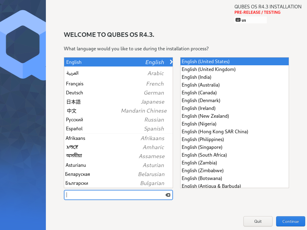

On the first screen, you are asked to select the language that will be used during the installation process. When you are done, select Continue.
Language selection window

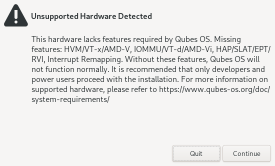

Prior to the next screen, a compatibility test runs to check whether IOMMU-virtualization is active or not. If the test fails, a window will pop up.
Unsupported hardware detected
Do not panic. It may simply indicate that IOMMU-virtualization hasn’t been activated in the BIOS or UEFI. Return to the Hardware requirements section to learn how to activate it. If the setting is not configured correctly, it means that your hardware won’t be able to leverage some Qubes security features, such as a strict isolation of the networking and USB hardware.

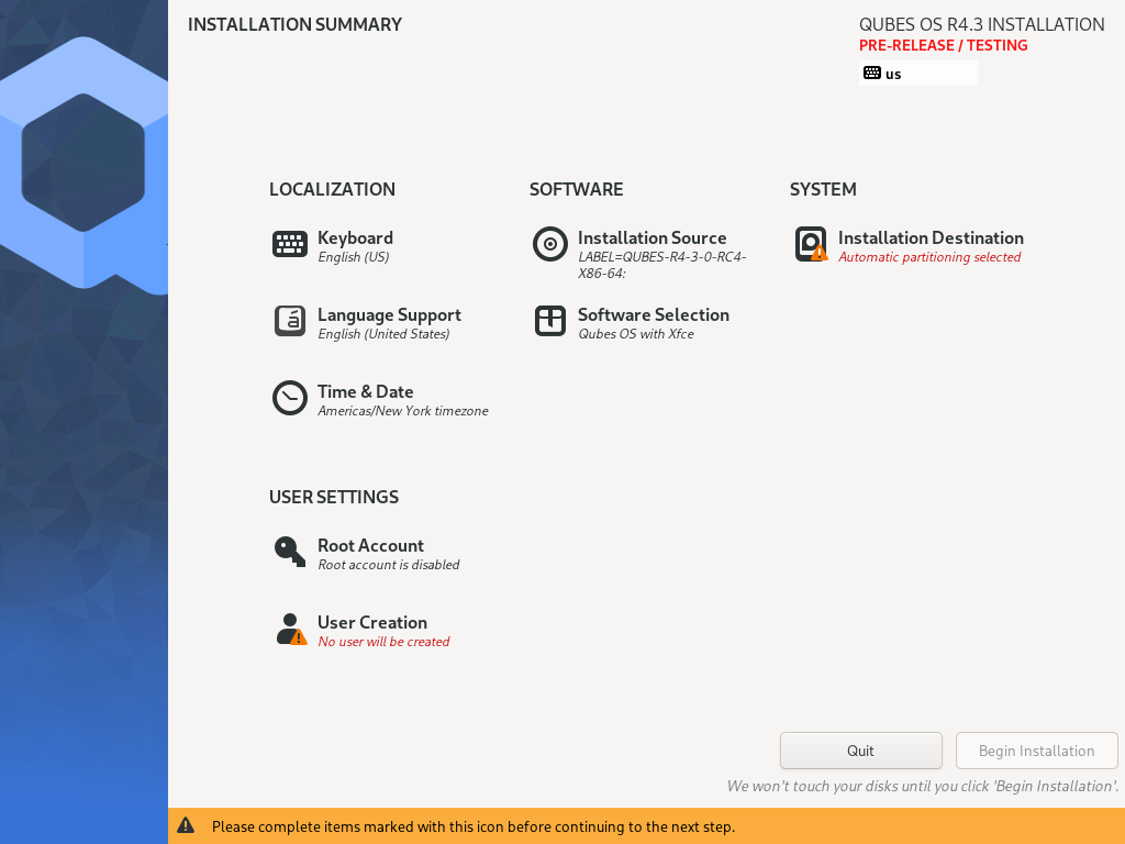

If the test passes, you will reach the installation summary screen. The installer loads Xen right at the beginning. If you can see the installer’s graphical screen, and you pass the compatibility check that runs immediately afterward, Qubes OS is likely to work on your system!
Like Fedora, Qubes OS uses the Anaconda installer. Those that are familiar with RPM-based distributions should feel at home.
Installation summary
Did you know?
The Qubes OS installer is completely offline. It doesn’t even load any networking drivers, so there is no possibility of internet-based data leaks or attacks during the installation process.
The Installation summary screen allows you to change how the system will be installed and configured, including localization settings. At minimum, you are required to select the storage device on which Qubes OS will be installed.
Installation summary screen awaiting input

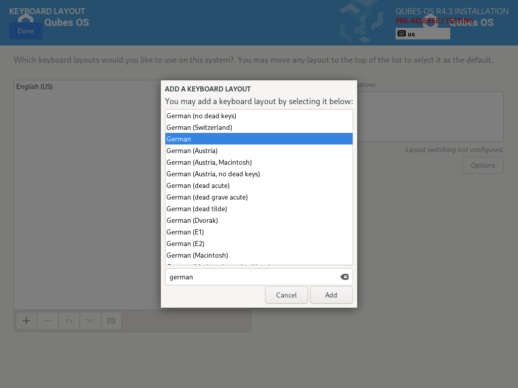

Let’s assume you wish to add a German keyboard layout. Go to Keyboard Layout, press the “Plus” symbol, search for “German” as indicated in the screenshot and press “Add”. If you want it be your default language, select the “German” entry in the list and press the arrow button. Click on “Done” in the upper left corner, and you’re ready to go!
Keyboard layout selection

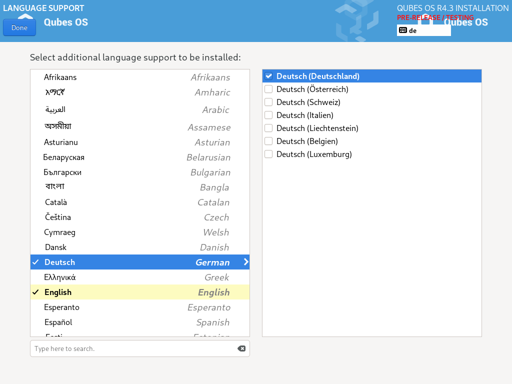

The process to select a new language is similar to the process to select a new keyboard layout. Follow the same process in the “Language Support” entry.
Language support selection
You can have as many keyboard layout and languages as you want. Post-install, you will be able to switch between them and install others.

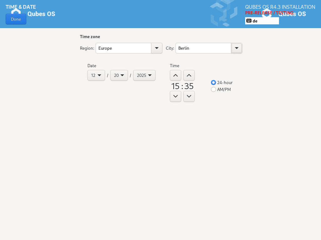

Don’t forget to select your time and date by clicking on the Time & Date entry.
Time and date

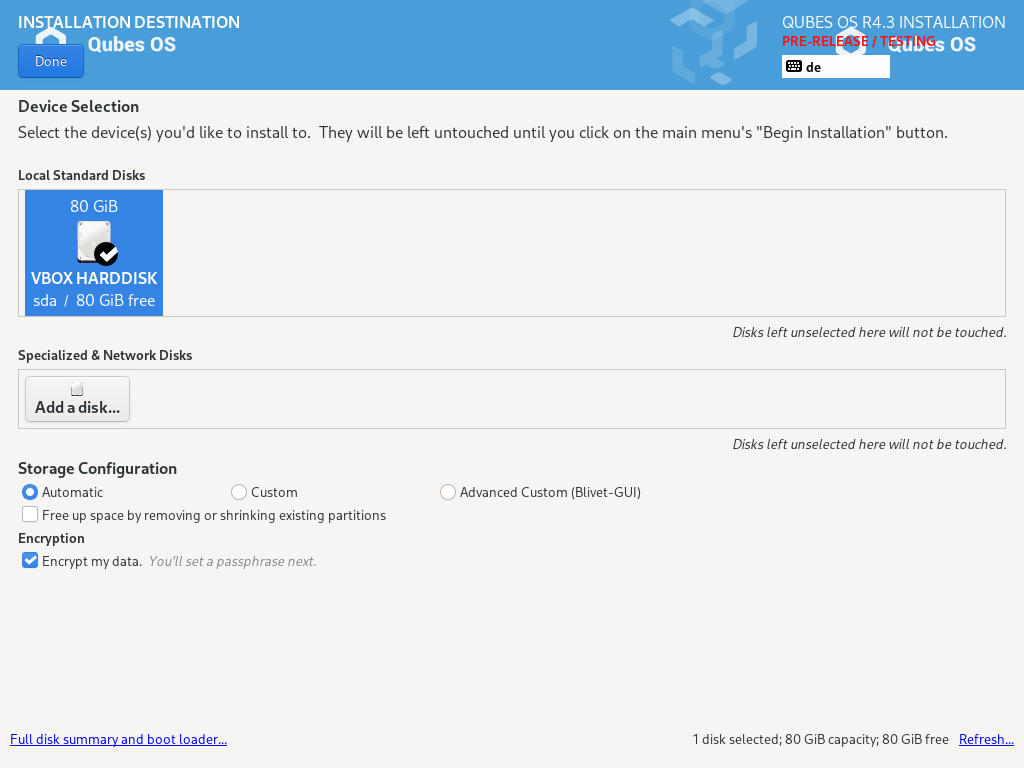

Under the System section, you must choose the installation destination. Select the storage device on which you would like to install Qubes OS.
Danger
Be careful to choose the correct installation target, or you may lose data. We strongly recommended making a full backup before proceeding.
Your installation destination can be an internal or external storage drive, such as an SSD, HDD, or USB drive. The installation destination must have a least 32 GiB of free space available.
Warning
The installation destination cannot be the same as the installation medium. For example, if you’re installing Qubes OS from a USB drive onto a USB drive, they must be two distinct USB drives, and they must both be plugged into your computer at the same time. (Note: This may not apply to advanced users who partition their devices appropriately.)
Installing an operating system onto a USB drive can be a convenient way to try Qubes. However, USB drives are typically much slower than internal SSDs. We recommend a very fast USB 3.0 drive for decent performance. Please note that a minimum storage of 32 GiB is required. If you want to install Qubes OS onto a USB drive, just select the USB device as the target installation device. Bear in mind that the installation process is likely to take longer than it would on an internal storage device.
Select storage device screen
Did you know?

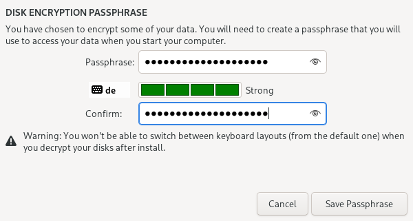

By default, Qubes OS uses LUKS /dm-crypt to encrypt everything except the /boot partition.
As soon as you press Done, the installer will ask you to enter a passphrase for disk encryption. The passphrase should be complex. Make sure that your keyboard layout reflects what keyboard you are actually using. When you’re finished, press Done.
Danger
If you forget your encryption passphrase, there is no way to recover it.

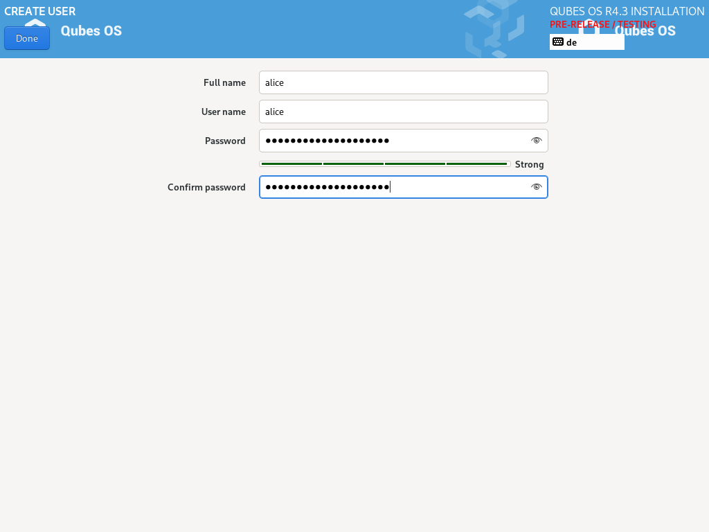

Create your user account
Select “User Creation” to create your user account. This is what you’ll use to log in after disk decryption and when unlocking the screen locker. This is a purely local, offline account in dom0. By design, Qubes OS is a single-user operating system, so this is just for you.
The new user you create has full administrator privileges and is protected by a password. Just as for the disk encryption, this password should be complex. The root account is deactivated and should remain as such.
Account name and password creation window.

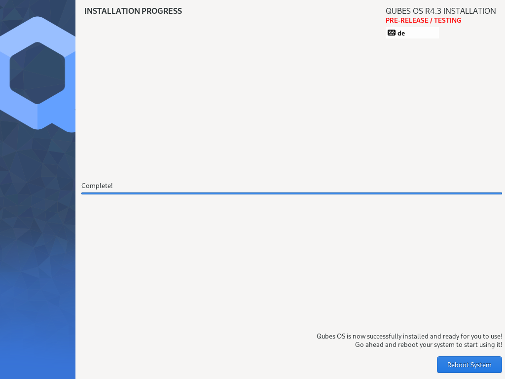

When you have completed all the items marked with the warning icon, press Begin Installation.
Installation can take some time.
Windows showing installation complete and Reboot button.
When the installation is complete, press Reboot System. Don’t forget to remove the installation medium, or else you may end up seeing the installer boot screen again. Also disconnect any unneeded USB devices which are connected to the machine, including Security dongles, mouse or keyboard. (Do not disconnect USB mouse or keyboard if these are your primary devices). If you do not do this the second stage install might take decisions on your behalf lowering your security model (ie: dongles or USB keyboard being connected on next boot will punch holes so that USB keyboard can be used to control dom0, which might or might not be desired).

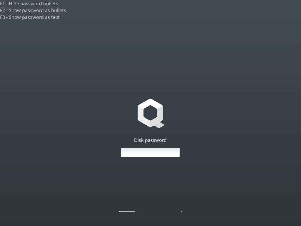

Just after this screen, you will be asked to enter your encryption passphrase.
Screen to enter device decryption password

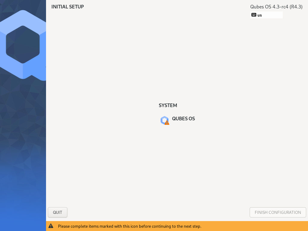

Initial Setup
You’re almost done. Before you can start using Qubes OS, some configuration is needed.
Window with link for final configuration Click on the item marked with the warning triangle to enter the configuration screen. Initial configuration menu

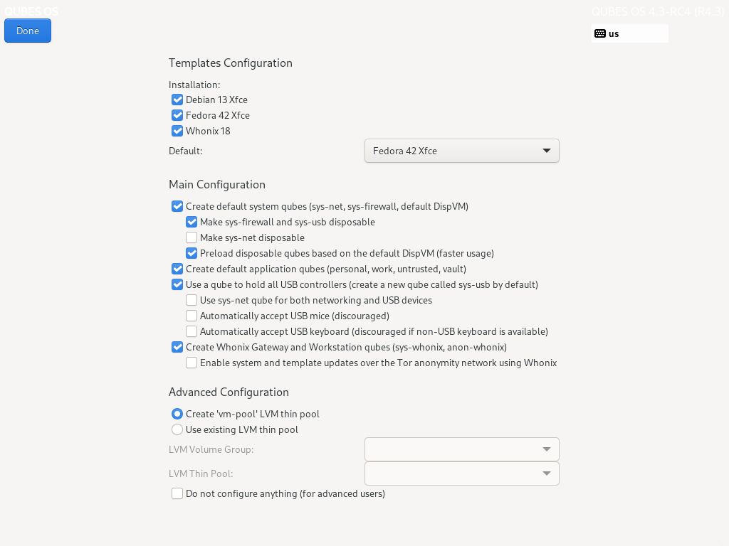

By default, the installer will create a number of qubes (depending on the options you selected during the installation process). These are designed to give you a more ready-to-use environment from the get-go.
Let’s briefly go over the options:
Templates Configuration
This section provides the templates you wish to install and which one to use as the default one. The default template settings can always be changed after this initial configuration too.
Main Configuration
Create default system qubes (sys-net, sys-firewall, default DispVM): These are the core components of the system, required for things like internet access.
Make sys-firewall and sys-usb disposable: The qubes responsible for firewalling/isolating network traffic and holding certain hardware devices like USB, Bluetooth adapter, integrated cameras, etc. (sys-usb only, if applicable) will be made disposable. Enabled by default as it fits most users’ needs.
Make sys-net disposable: The net qube handling your network devices will be made disposable. This will result in loss of stored Wi-Fi passwords and therefore automatic Wi-Fi connections each time the qube gets booted. Disabled by default for a more user-friendly experience but if you don’t mind storing the aforementioned passwords e.g. in an offline password manager, you may turn it on for privacy enhancements (no broadcasting of saved Wi-Fi network names). You might also customize the disposable net qube so that your Wi-Fi credentials will be passed dynamically.
Preload disposable qubes based on the default DispVM (faster usage): If your computer has enough memory, this option will be enabled by default and transparently enqueue several disposables in the background for faster startup.
Create default application qubes (personal, work, untrusted, vault): These are how you compartmentalize your digital life. There’s nothing special about the ones the installer creates. They’re just suggestions that apply to most people. If you decide you don’t want them, you can always delete them later, and you can always create your own.
Use a qube to hold all USB controllers (create a new qube called sys-usb by default): A dedicated qube that holds certain hardware devices like USB, Bluetooth adapter, integrated cameras, etc. (sys-usb) will be created.
Use sys-net qube for both networking and USB devices: certain hardware devices will be held by sys-net instead. You should select this option if you rely on a USB device for network access, such as a USB modem or a USB Wi-Fi adapter, as this option will make the experience with them more user-friendly and seamless.
Automatically accept USB mice (discouraged): If enabled, upon the connecting of a device that presents itself as a USB mouse, it will be automatically forwarded to dom0. Disabled by default so once such device is connected, manual user interaction is required to confirm forwarding that device. This results in additional security benefits - e.g. a malicious device presenting itself as a mouse will be rendered useless until a confirmation dialog in dom0 is accepted.
Automatically accept USB keyboard (discouraged if non-USB keyboard is available): See the point above about USB mice. The same applies here. Enabling this is mostly beneficial to modern stationary workstations where only a USB keyboard can be used for typing. If you can use a PS/2 keyboard (generally laptops use an emulated PS/2 for their internal keyboards), you may want to leave this option disabled for additional security.
Warning
Note: When choosing to automatically accept USB mice or keyboards, be aware of the security considerations. For troubleshooting non-working devices, see this document.
Create Whonix Gateway and Workstation qubes (sys-whonix, anon-whonix): If you want to use Whonix, you should select this option.
Enable system and template updates over the Tor anonymity network using Whonix: If you select this option, then whenever you install or update software in dom0 or a templates, the internet traffic will go through Tor.
Advanced Configuration
Use custom storage pool: Here you can specify custom names for the LVM pool holding your qubes’ filesystems as well as LVM Volume Group name. Unless you’re preparing a customized environment on your machine (e.g. dual booting distinct Qubes OS releases), you can leave this option unchecked.
Do not configure anything (for advanced users): This is for very advanced users only. If you select this option, you’ll have to set everything up manually afterward.
When you’re satisfied with your choices, press Done. This configuration process may take a while, depending on the speed of your computer and the selected options described above (the more templates to be installed, the longer the configuration process will take).

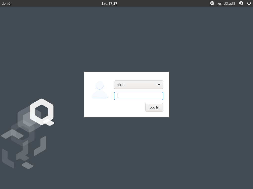

After configuration is done, you will be greeted by the login screen. Enter your password and log in.
Login screen

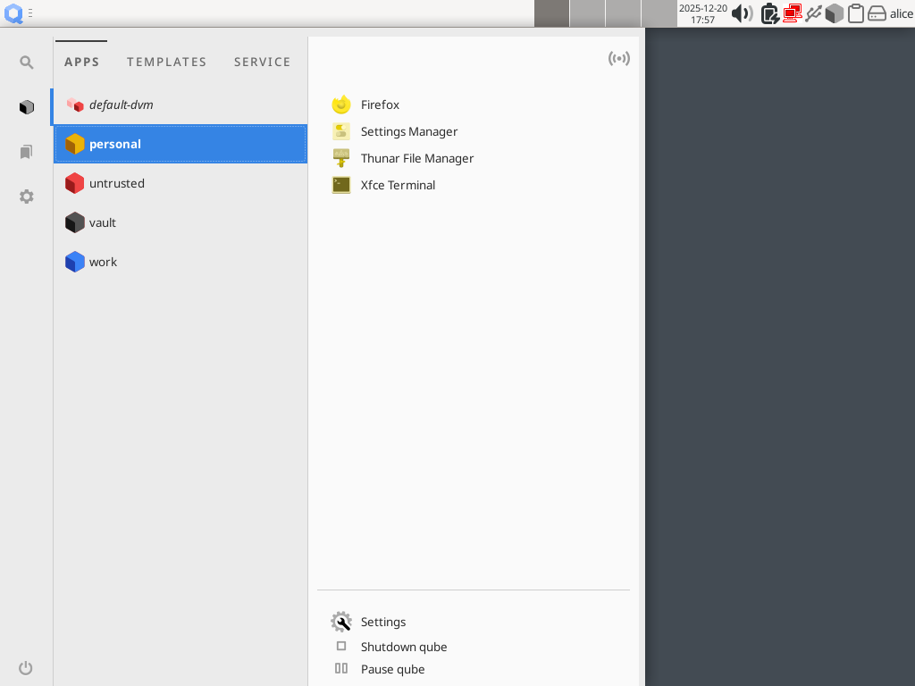

Congratulations, you are now ready to use Qubes OS!
Desktop menu
