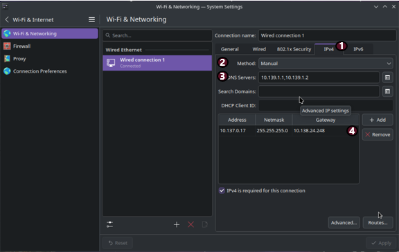

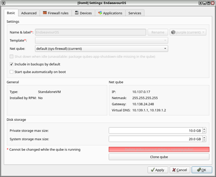

An example of setting up a network - Network Manager on KDE
Every guest operating system has its own way of handling networking, and the user is referred to the documentation that comes with that operating system. However, Network Manager is widely used on Linux systems, and so a worked example will prove useful. This example is for an HVM running EndeavourOS.
Image of Qube Settings
In this example, Network Manager on KDE, the network had the following values:
  1. IPv4 networking
  2. IP address 10.137.0.17
  3. Netmask - qube settings showed 255.255.255.255, but we decided to use 255.255.255.0
  4. Gateway 10.138.24.248
  5. Virtual DNS 10.139.1.1 and 10.139.1.2
Image of Network Manager, annotated by numbers for reference below
The network was set up by entering Network Manager, selecting the Wi-Fi & Networking tab, clicking on the Wired Ethernet item, and selecting tab IPv4 (1). The Manual method was selected (2), which revealed areas for data entry. The DNS Servers section takes a comma-separated list, here 10.139.1.1,10.1.139.2 (3). At the bottom of the tab (4), the ‘+ Add’ button was selected, and the IP address of 10.137.0.17 entered in the ‘Address’ column, the Netmask of 255.255.255.0 entered in the ‘Netmask’ column, and the Gateway of 10.138.24.248 under ‘Gateway’. Selecting the “Apply” button stored these changes

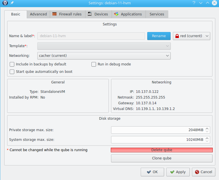

[joanna@dom0 ~]$ qvm-prefs my-new-vm
autostart           D  False
backup_timestamp    U
debug               D  False
default_dispvm      D  None
default_user        D  user
gateway             D
gateway6            D
include_in_backups  -  False
installed_by_rpm    D  False
ip                  D  10.137.0.122
ip6                 D  fd09:24ef:4179::a89:7a
kernel              -
kernelopts          D  nopat
klass               D  StandaloneVM
label               -  red
mac                 D  00:16:3e:5e:6c:00
management_dispvm   D  default-mgmt-dvm
maxmem              D  0
memory              -  1000
name                -  my-new-vm
netvm               -  sys-firewall
provides_network    -  False
qid                 -  122
qrexec_timeout      D  60
shutdown_timeout    D  60
start_time          D
stubdom_mem         U
stubdom_xid         D  -1
updateable          D  True
uuid                -  54387f94-8617-46b0-8806-0c18bc387f34
vcpus               D  2
virt_mode           -  hvm
visible_gateway     D  10.137.0.14
visible_gateway6    D  fd09:24ef:4179::a89:e
visible_ip          D  10.137.0.122
visible_ip6         D  fd09:24ef:4179::a89:7a
visible_netmask     D  255.255.255.255
xid                 D  -1
[joanna@dom0 ~]$ qvm-clone my-new-vm my-new-vm-copy
