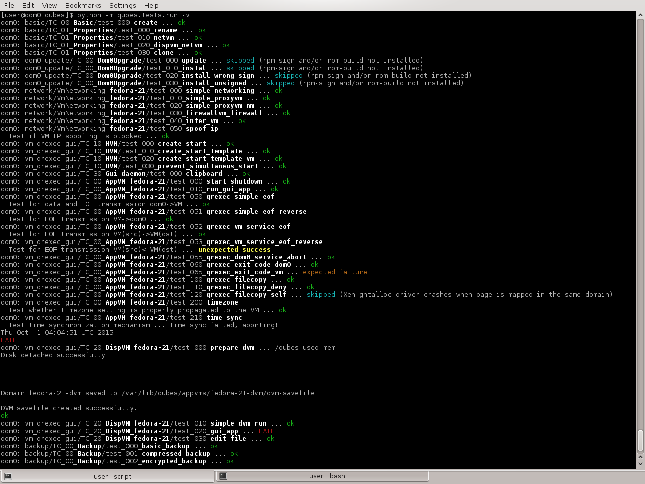

Example test run:

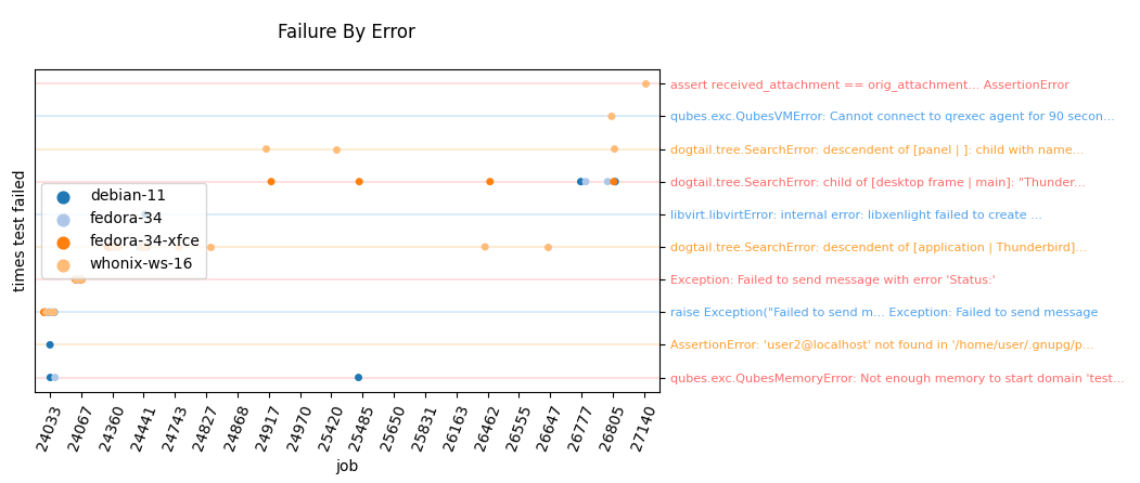

Looking for patterns in tests
In order to better visualize patterns in tests the openqa_investigator script can be used. It feeds off of the openQA test data to make graph plots. Here is an example:
Some outputs:
  • plot by tests
  • plot by errors
  • markdown
Some filters:
  • filter by error
  • filter by test name
Check out the script’s help with python3 openqa_investigator.py --help to see all available options.
